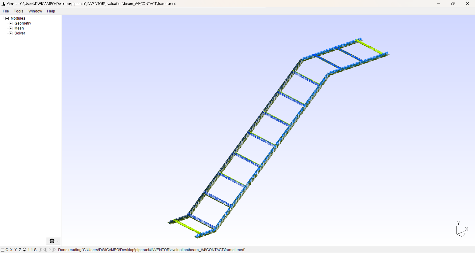

Regarding the mesh, please don't assume it is poorly made; it was actually created based on my current level of knowledge. It is in MED 4.0 format—that might be the issue. I was able to open both files in Gmsh, even though I am not very familiar with the software. If it is a version-related issue, I can change the MED version.
